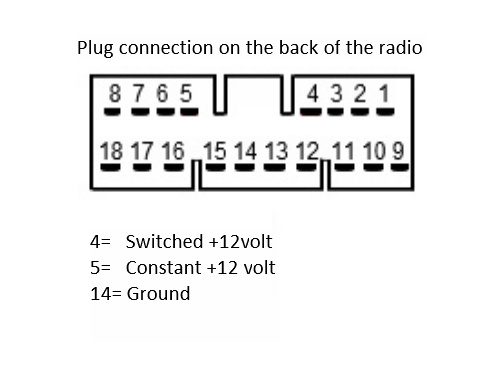

Check the plug connections and wiring behind the radio,
check the fuse and contacts in the fuse box (corrosion, poor contact),
Check that you have a constant +12 volt power supply
and a switched +12 volt power supply.
Check that you have a ground in the plug connection;
(see the image for the correct contacts).
